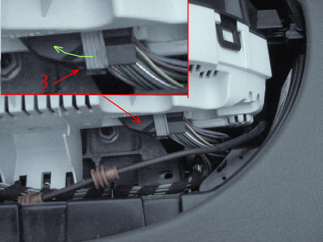

Did the instrument cluster completely go dead, including speedo?
If I remember correctly on the G500 it is connected by a large plug at the back, if the plug is not in 100% or comes loose it loses the connection and won't work, looking like a dead instrument cluster. Undoing the clip and putting the plug back on tightly should do the trick.
Good picture of similar setup here?:
http://www.aclassinfo.co.uk/W168/Inst%20cluster%20muti%20plug.JPG
Good instructions some way down the page
