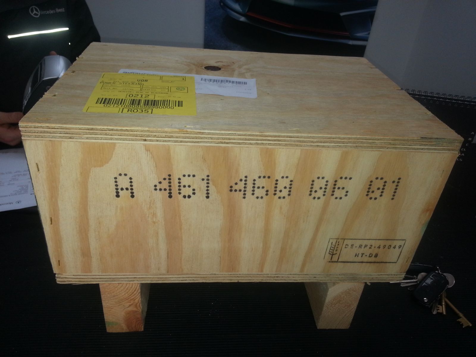

I collected the new steering box today and hope to get it fitted tomorrow. I'm having it stripped down and quite a few things replaced for new MB parts including a few body panels.I've alreay got all of the regular service items like filters, belts, plugs but we're in stripping down mode at the moment. We're hoping to retain the original alternator by reconditioning. When we are happy with the mechanicals it is being stripped and fully painted in the original silver.
I'm not used to driving 2nd hand cars especially 30 year old ones so I want to make it like it was when it was new. I just see myself as the current custodian who will bear the costs of renovation instead of the usual depreciation. I like my vehicles to be "Bob on" so that I can enjoy their use and I'm currently migrating from one of these http://www.tonyraynor.co.uk/must-have-advice-for-british-drivers-in-france/
The steering box arrive in the most serious of wooden packing crates like a case of fine wine. Pictures tomorrow ....

So it's called a steering box because it arrives in a box!

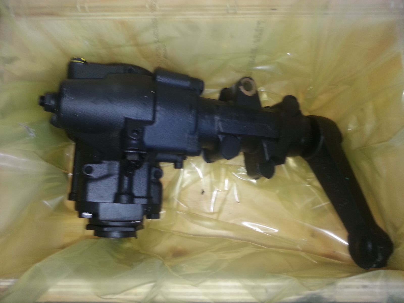

Re: New Steering Box ordered for 84 280GE
This is what a brand new steering box looks like (not at all boxy)!
Nice looking box...i didnt think i would ever see anybody buy one of these in the UK!!!
I hope you pushed the dealer for 20% discount!?!
