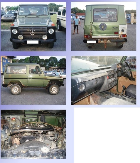

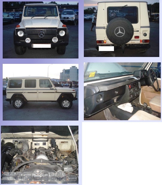

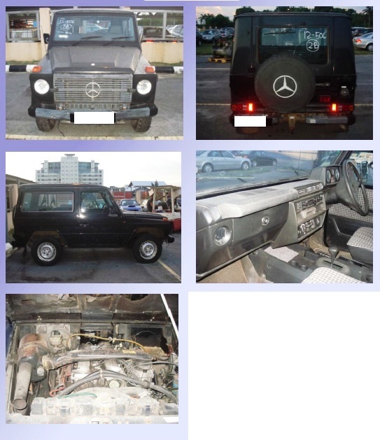

Hi hello. I amnew to this site as i dont have a G wagon yet. Need the advice of all the experts here. There are currently 3 vehicles for sale in my country. I believe they were probably imported from the UK. They have been lying around in the shiptard probably a few years. One is a 230E, a 280GE and a 300GD. BTW they are being sold quite cheap between 2-4000 pounds. I have not seen them yet detailed oics will be uploaded later. Any input would be appreciated...would be a good move to buy if they are cheap...

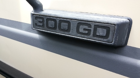

300GD WAGON

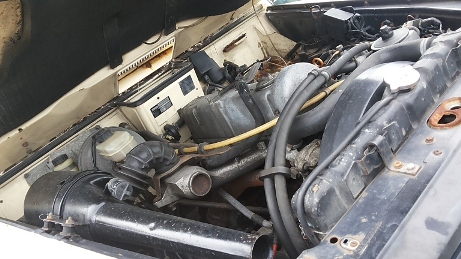

280GE WAGON

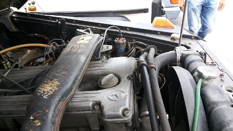

230 E WAGON

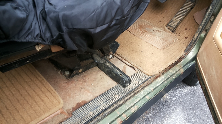

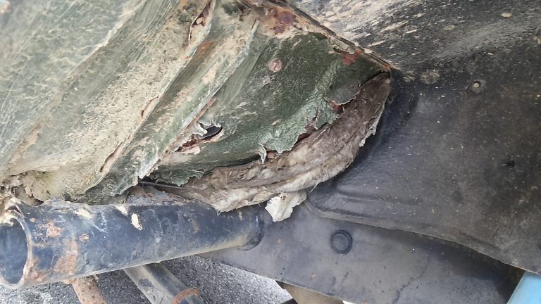

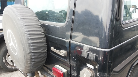

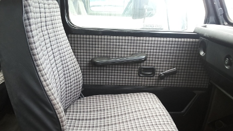

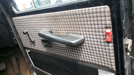

look for rear 3/4 rust in all of them, the interior is a good indicator of how a vehicle has been looked after, that should give you a very clear answer
Avoid it. Conditions quite bad. You'll need a lot of money to make it roadworthy. I think this model is very rare in Malaysiya (problems for spares) unlike here in Europe.

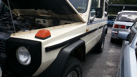

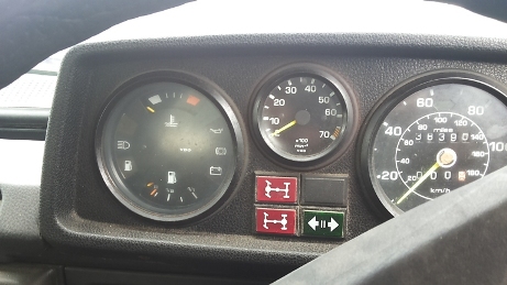

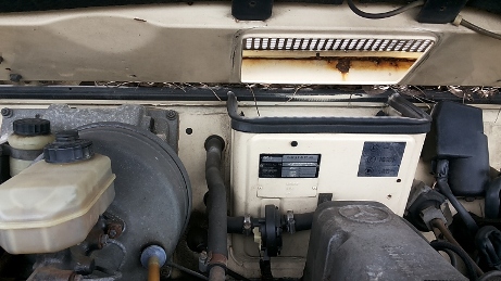

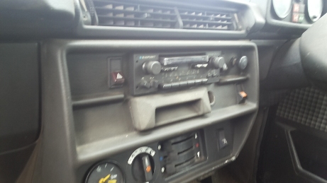

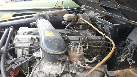

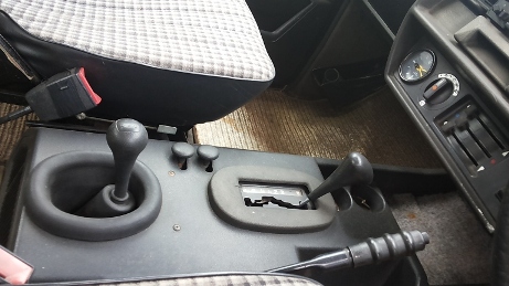

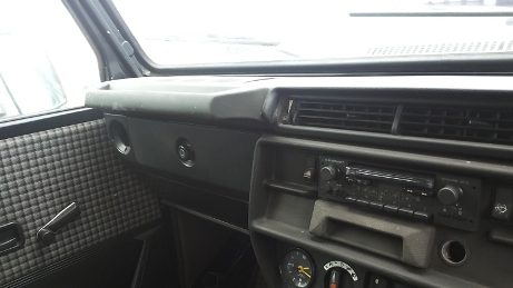

I have looked at the photos as you requested on my PM. Let me re-iterate my caution to you. My views are only my opinion and based evidence on photos and in the absence of first hand information. My advice is against choosing a vehicle which you have not had professionally inspected or test driven.
I feel the price is high based on market prices here in the UK for conditions of vehicles. Neither, the GWOA or myself can be held liable for any wrong advice we may unintentionally give. The views I present are based on the visual evidence you have shown.
You have two SWB and one LWB; although both give a good ride, all things being well, in comparison the LWB give a smoother ride than the SWB.
If you are a family member with young children; it can be cumbersome to let them in and out of the vehicle. In particular if the child is a baby, it is more awkward to put baby seat in and out of the rear seat. Vehicles pre 1984 did not have central locking which is very much a must for creature comfort.

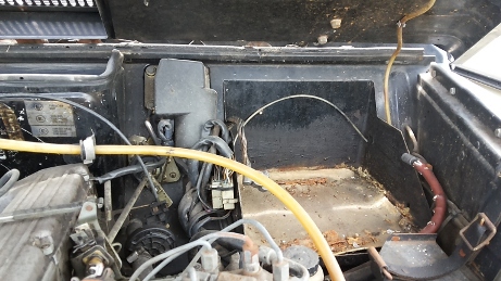

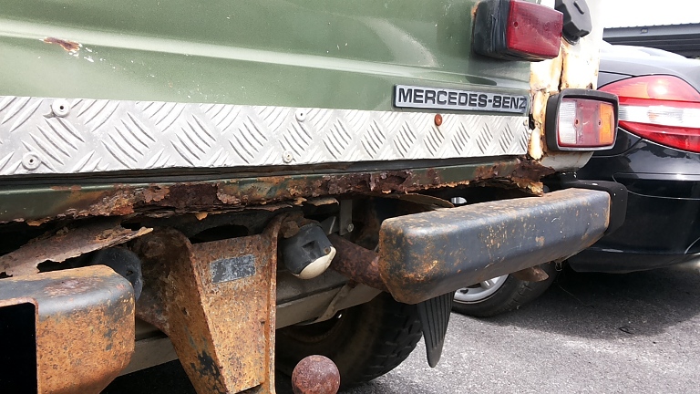

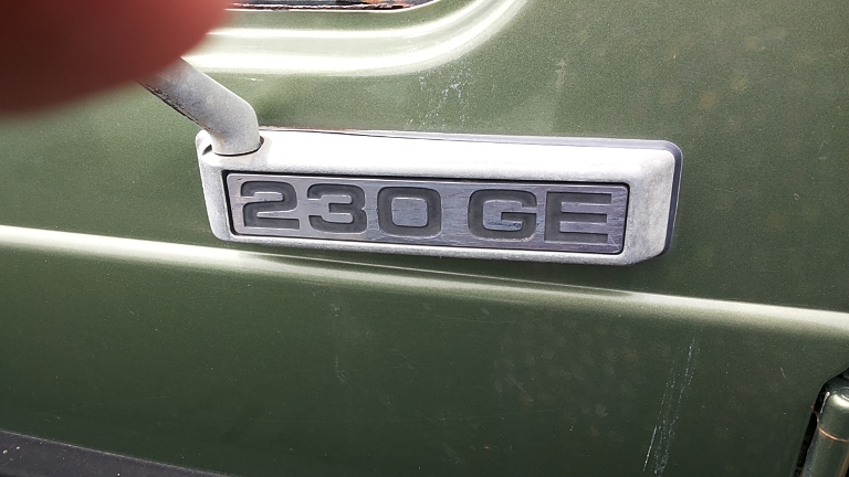

The 230GES (SWB) is clearly off my list of any suggestion, it has too much body rot in the rear panels and is general a rough looking vehicle. Cost to restore any vehicle in this condition will be high. Generally, a good urban vehicle, nippier than a 280GE but a poor touring vehicle.

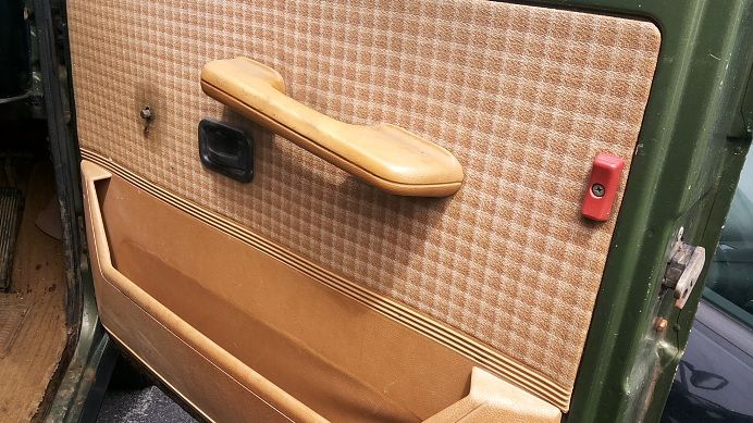

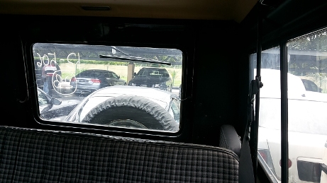

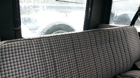

The best presented vehicle is the 300GDL (LWB) but a slow vehicle, can easily bottoms out on extreme offroading and great for a large family, the kids love sitting in the rear. My second choice is the 280GES.

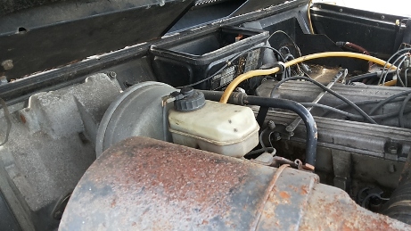

In all cases you DO need to have the vehicles fully inspected and tested. Let me run through the negatives of these. Exhausts systems of all these models have a high initial outlay, to replace the whole system. But the system does last between 6 to 10 years and spreading the out lay over this period makes the system no more the dearer than any other vehicle.

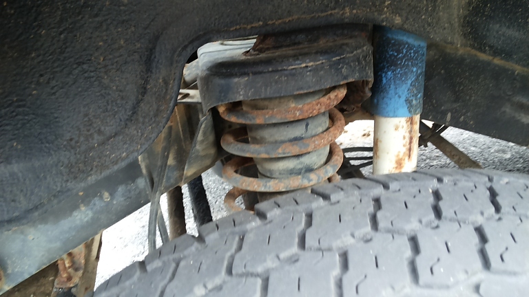

The fuel tanks can be an issue. Metal tanks are no longer available and the plastic replacement and fitting kit can take the bill up to £1400. The rear coil can break top and bottom and can be easily missed on inspection; best checked out with vehicle body jacked up and of course supported by axle stands before any one considers crawling under the vehicle.
Prop. shafts need to be checked for excessive joint wear and vibrations whilst running the vehicle, there are three prop shafts in the drive train and on average each new shaft is some £900 new. In the last five years or so a new weakness is showing up in the older G-Wages and that is chassis corrosion in particular at the rear top coil spring cups, these rot at the tubes the cups are welded to. Check for any bubbling in this area, the rot starts internally and works out. Repair parts are available and the new pieces welded in but does require some degree to lift the body off the chassis.

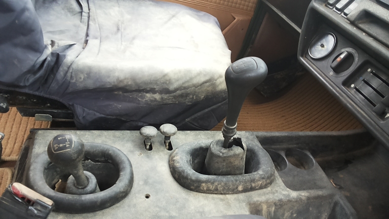

Have the front and rear diff locks tested out, if fitted. The front wheel bearings need to be checked out, any excessive play found means replacement bearings, adjusting the play out is no good. The bearings set(s) are some £300 and 5 hrs labour per side of axle. Radiator blockages can cost £500 replacement, cheaper to re-core. This should not an issue for you as I expect there would be lots of radiator repairs in your country. Worn wiper spindles can cost £130 to renew the part. So, this is why I am adamant of having the vehicle professionally inspected before you commit to any one of these vehicles. A long term standing vehicle can erode the fuel metering body internally, which can be over a £1000 to replace, so to see a properly running engine is crucial! Brakes can be seized after a long standing, tyres develop flat spots.
Despite the negative picture listed above, once the vehicle is up to scratch, these are one of the most reliable and effective offroaders provide they are maintained.

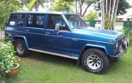

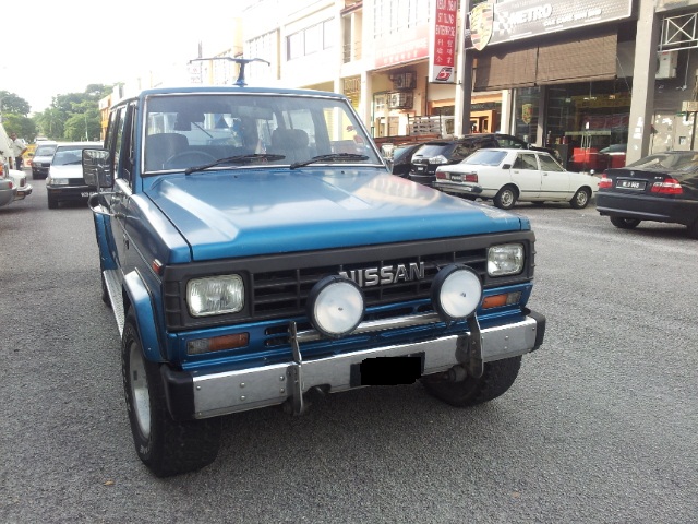

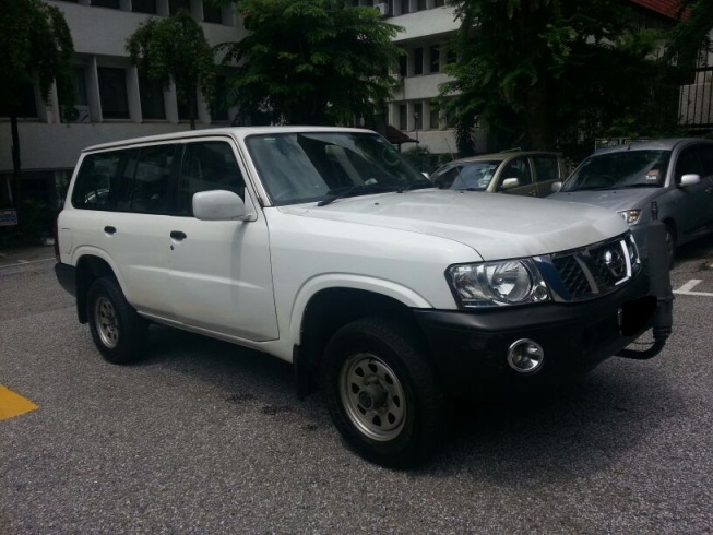

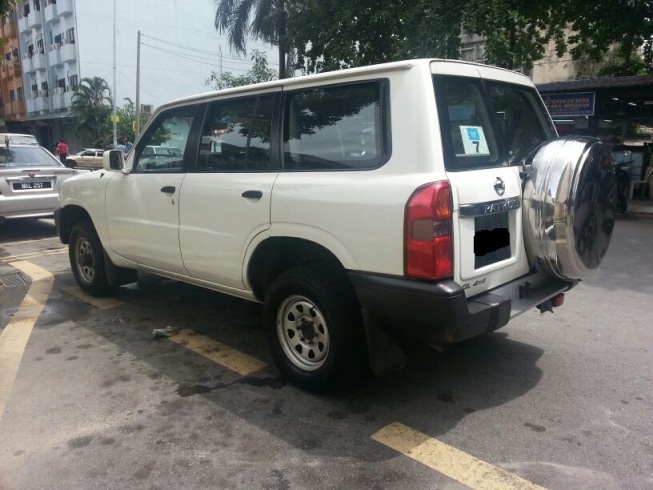

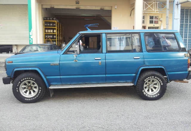

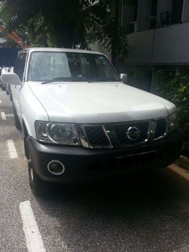

Sadly not a G-Wagen, given the selections available at the time to have had, I am sure this is a good choice. It is tidy looking, no doubt, reliable but how did it fare on price to the budget you wanted to spend on a G-Wagen?
I do not have experience of Japanese off roaders but do tell us of it equipment level in terms of front or rear lock diffs, etc...

Very nice - ENJOY. Thank you for the photos.
Happy Christmas.

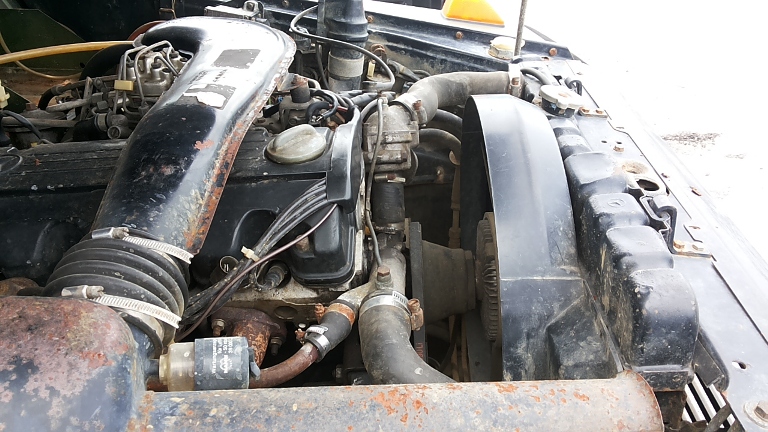

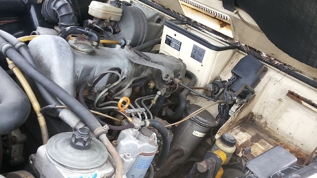

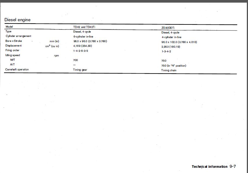

Aaah - the engine that never dies !
The [ Datsun ] Nissan TD42 engine is one of the worlds great engine families - not seen in europe since the 90's- I did'nt realise it was still produced for some markets
From little 2.3's [ vanette ] forklifts and trucktrailer 'fridge motors to the wonderful [ and rarely recognised as such ] TD27 turbo both manual and electronic from the Maverick / Terrano /Cabstar -the TD27 gearcam push rod engine is FAR superior to any Pajero / Trooper type engine and is widely used in West Africa as a transplant in Land rover / Range Rover vehicles and is good for 400.000 km's without a spanner
HOWEVER nothing except MB603 and Toyota landcruiser 6's come near the TD42 dating from the early 80's Patrols for longevity
You cant beat a sweet 6 !
Except for a well set up MB 602 of course - my new project is a 605 20 valve head on a low mileage 662 with big turbo ,7mm pump and fabricated manifolds - will post dyno results when done !
You won't get better vindication than that, as Tony says; he knows what he is talking off.
very sensible decision
