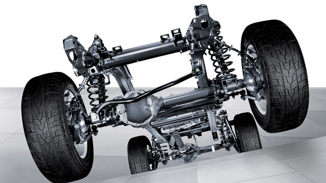

In fact the track rod only adjusts the amount of toe. The end of the steering rod, from the steering-box arm to the axle swivel-joint arm, is where some adjustment can be made.
Your understanding is correct.
The rear rod connects the left and right wheels together and determines the toe angle. These rods are so massive, that unless you've had a major bump or their ball-joints are worn, they don't normally require adjustment.
The front rod connects either the left (RHD) or right (LHD) wheel to the steering arm of the steering box. You can adjust this one to a small extent to centre the steering wheel. Again, I have never had to adjust this one, which is why i was thinking that if your steering wheel is not straight, either someone has had a previous go at 'tracking' or the other most likely cause is that the steering wheel has been removed for access to the dash, which is quite common.
Picture shows rear, steering rod,
Front steering rod is not shown, but axle-locating rod is shown.
Yes, mine was also LHD from Germany, and pulls a little to the left in the UK, but as I often go over to the continent with it, I decided to leave it alone, as on French motorways, it tracks dead straight.
Picture was just from the internet: search 'G-Wagen axle'
