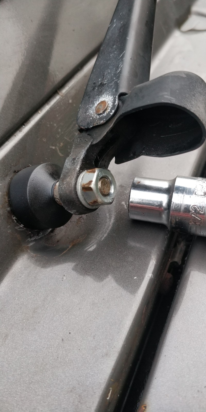

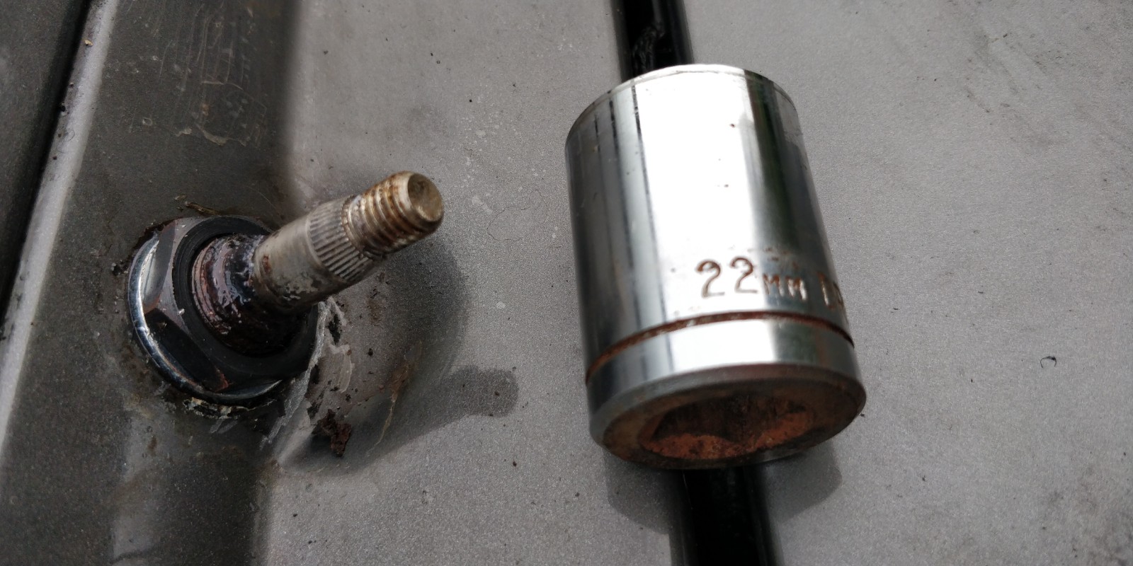

So as a first step - try just replacing the spindle seal and cover... I was able to get one from Mark van de Wal (both sides) for a reasonable sum.  My black plastic covers were shot, although washer and seal seemed good and no real movement in my spindle - it looked like a replacement.  Still, its a 15minute job, so worth doing.
To get the wiper arm off the spindle, after being screwed down for a while, apply some penetrating oil, then a piece of wood against the screen or frame so you can apply some leverage to the underside with a spanner - then tap tap tap with a small metal hammer to shock it off.
The Washer nut is 22mm and the Spindle nut is 1/2 inch.  The black plastic cover just snaps over the washer nut... you could pack with some grease first to deter water ingress, or even seal around the base with a bit of mastic.
