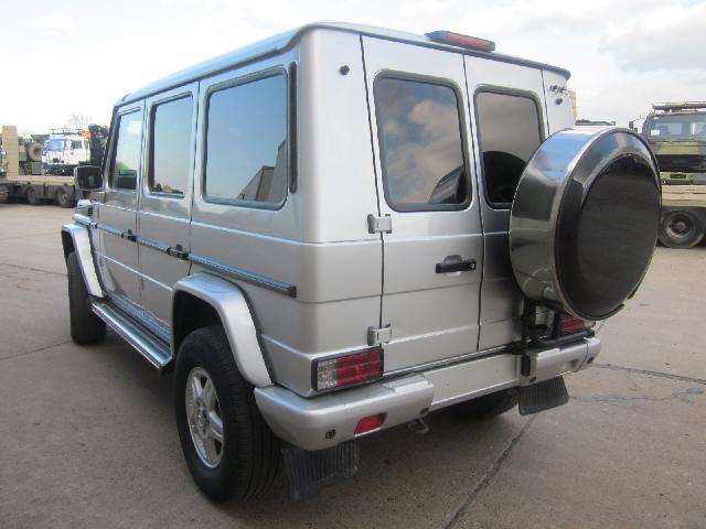

yes, probably a 461 vesion (G-Professional), which also had a dual 12V/24V system. I always really liked those and thought that thy remained truer to the original G concept than the 463. A kind of updated 460.
2018 Mercedes-Benz G-Class Professional Wagon on sale in Australia ...
Re: Need Combo Switch that Operates High/Low Beams, Turn ...
The other thing I liked about the 461 was that it came with the option of the rear 'barn doors'.
