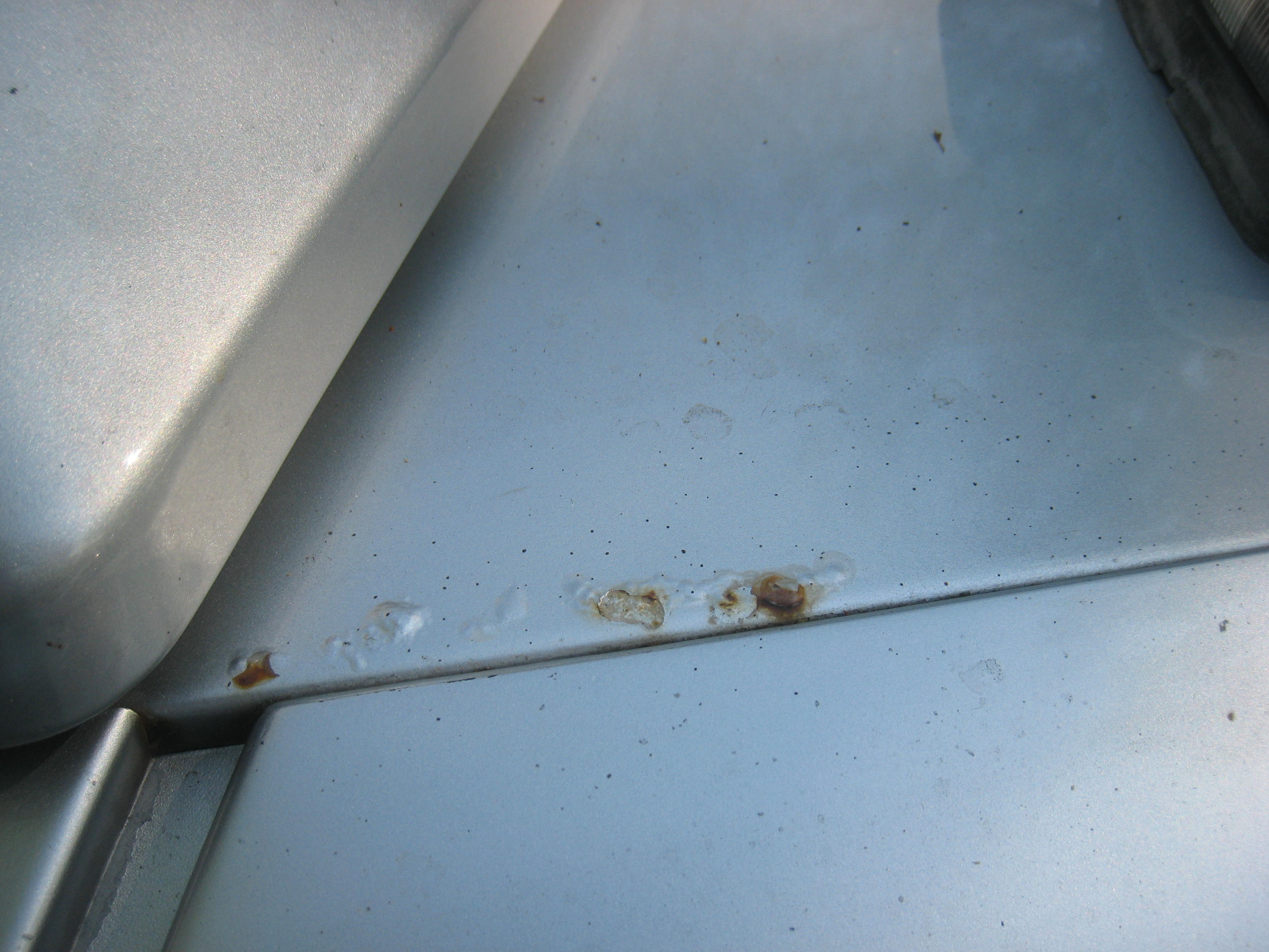

I've seen this on several other Gs so it's obviously a common problem. Anyone know why it happens here (on the wing just above the headlamp) and is there a special way to ensure it doesn't come back again when having this area painted?
Re: Dreaded rust
Because:
1) the plastic headlamp surround rubs on the paint and car wear it thin. Water can then wick-up through the broken paint edge.
2) the screw holes from the headlamp bracket also provide a broken paint surface, just below that.
3) the area behind the plastic surround rarely gets properly cleaned.
Its should be OK once treated and repainted.

You need to get that wing off and knock seven kinds of rust out of it, that's coming from the underside and from experience will probably require welding , treating and sealing,  zinc phosphate paint and stonechip or buy a new wing

The g wagon i am selling has the same issue. My g wagon that is no where near as tidy has no rust and is original
The rust on the new one . I asked if i could press on it and see if it was just surface rust or a rot hole. It was fine and was solid
Your pics are not clear to see how bad the rust is
If it was rotten its a nice flat surface easy repair that would last the life of the vehicle if done well. Dont worry about it. I would say to repair that at a good body shop would be 200 to 250 absolute maximum
This would be for  long term perfect repair. If just for looks and it would not last long i would say 120

Cut rust out and weld plate in if required
If its just surface rust and no pin holes of rot or rust worm . Sandblast area and check for any holes. If there are any cut and weld . If not and underside of wing is perfect rust free
Coat with epoxy primer after sandblasting. This stuff is hard to sand and is perfect and seals out any moisture or water. Flat off and then apply top coat
If the rest of the wing is perfect and mint i would just repair that part of it. Check wing thoroughly as it would be a shame to have to repair another part in a short while later

The wing will 100% need to come off if you want to do it right.
Yes you can scuff/fill and paint it to bodge it up for a year until more rust comes through, but I bet any money there will be other areas of this wing that need welding and painting, ie around rubber trim fixings, and probably a little part of the inner wing which is easily accessible while the wing is off.
Like Graham said, have the wing off, knock 7 bells out of the rust, have it repaired properly with seam welds and new metal, zinc primer, stone chip etc the inside, and 2k primer/paint the outside as normal. No point doing things by halves, as you'll have do it over and over again.

You had me doubting my sanity there so I returned to removing the headlamp surround (can't really call the front and the back both a cowl. But the "cowl" at the rear of the headlamp doesn't remove I think it's either riveted or welded in place (pictures attached).
So then removed wheel and plastic wheel arch liner for good look at top front of wing.
The doomsayers were right - the rust is coming through from underneath. there's a strip about 50mm wide and 15cms long across the top on the wing.
I'm guessing that the correct solution is to remove the wing- how difficult that (for someone stupid, like me)? It looks like it's just nuts and bolts.
Anyone know how much a new wing would cost?

Cut and weld it is then.
Ideally I'd like to remove the wing myself so I can take it to the welder minus the top of wing indicator to allow for a perfect respray and avoid probability of welder saying he can do the job with wing in place and me regretting a less than perfect job for ever after.
But just how easy is it to take the wing off (and then put it all back together again).

Bloody hell Mark you are worrying too much
Just unbolt it but be careful if there is any sealer and trim it carefully so you dont flex the wing on removal
Bring it to me i will tig it up and you will hardly need any filler. Just some epoxy primer. (amazing stuff)
Any good vehicle restorer or bodywork shop that knows their stuff will be able to do it mate
Seal the wing and fit back on car then paint on the car in case it needs blending in. No matter how good a paint match it wont match the rest unless you blow it in down the doors to hide the colour change no matter how slight
Also if you paint it off the car you are bound to scratch it when re fitting it

Wing now removed.
Who would have thought there would be so many nuts, bolts and screws (not to mention bits of trim, lighting connectors, etc. etc.
Glad I've done it though - it's off to be cut, welded and painted tomorrow.
