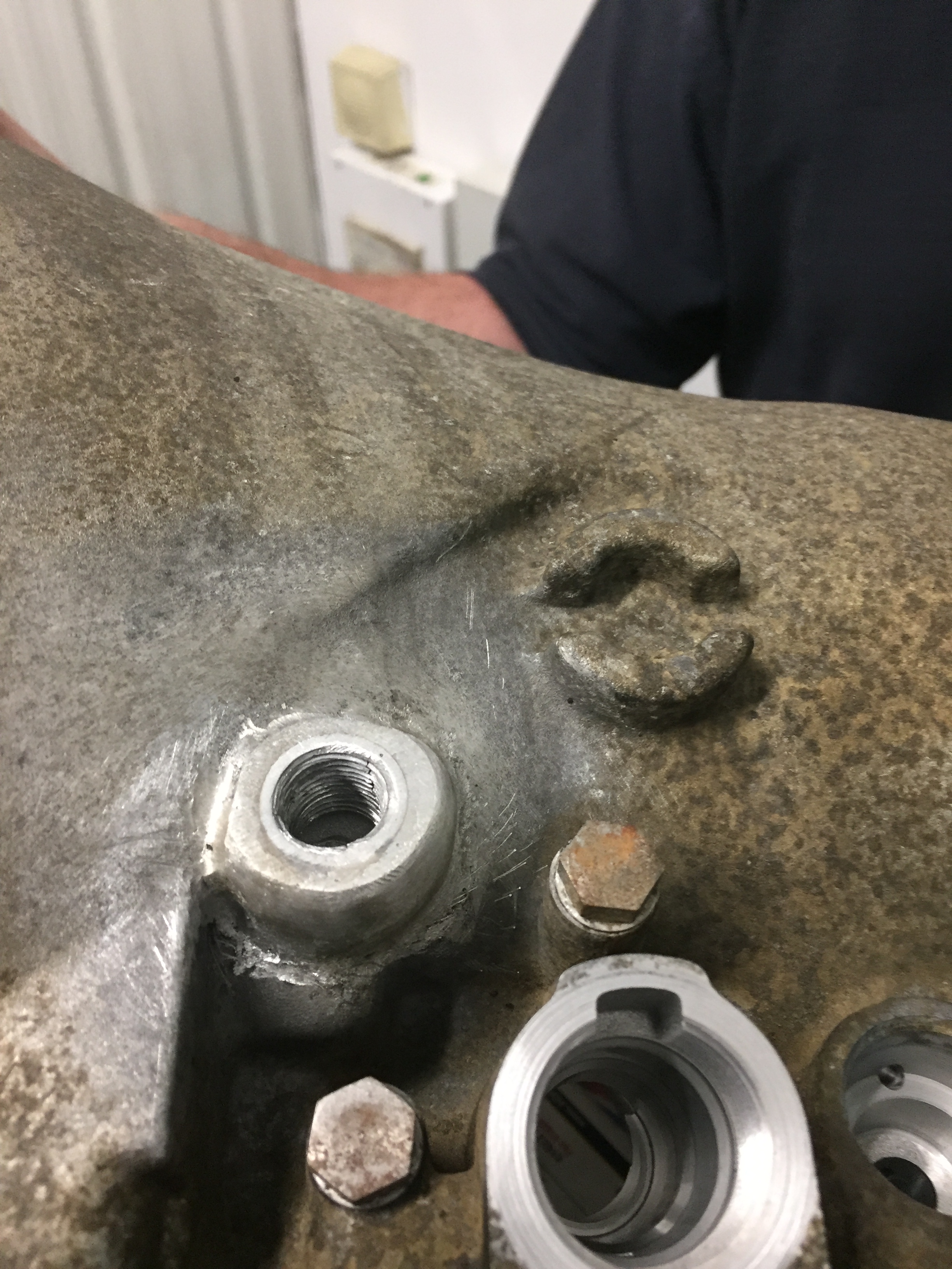

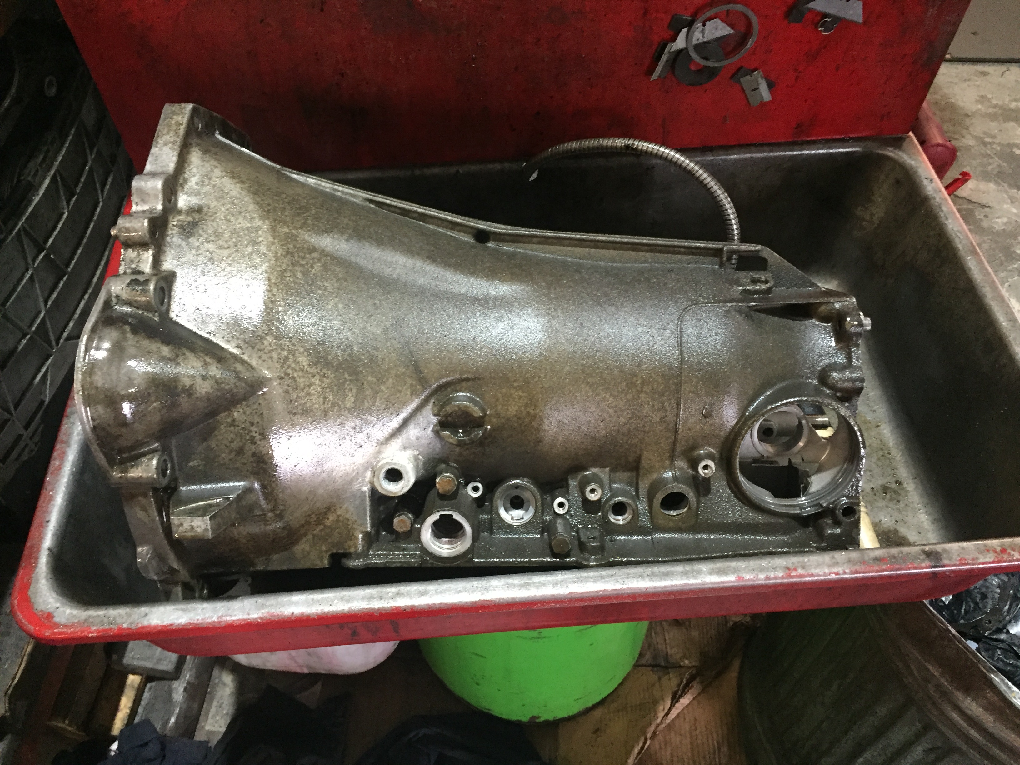

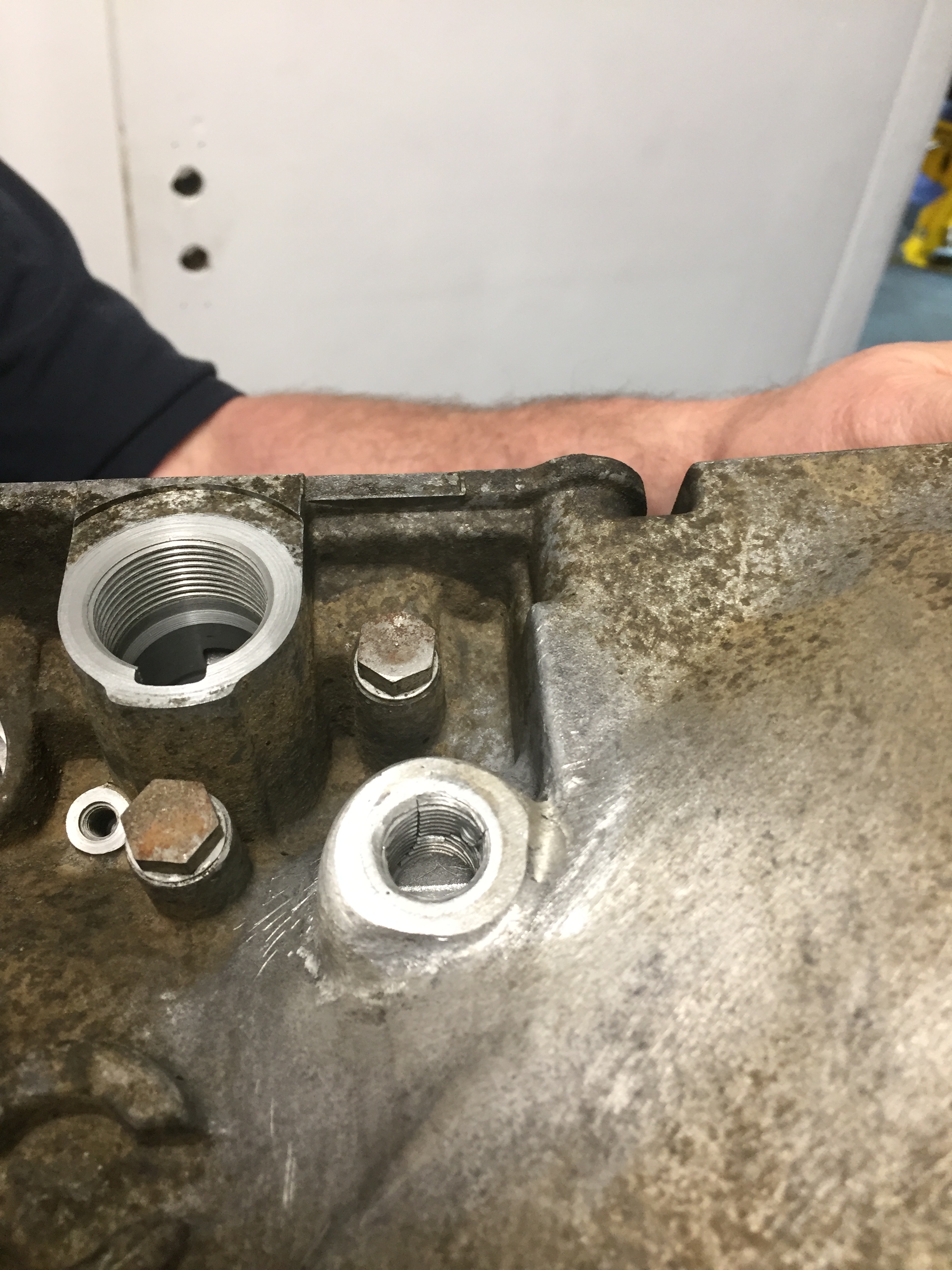

Hi   I am part way through a auto gearbox overhaul
There are a number of cracks where the transmission fluid pipe bolts onto the large gearbox case.
Does anyone have a good gearbox case to suit my 1993 GEL 300
My G Wagon is stuck high up on a ramp in a garage and is going no where
Can any body help
Part Number is 722397 or maybe a 7223 may be suitable
Can you advise    Regards from Les

I could tig it up for you and i am sure it would be fine
Is it just around that one fitting. I have enlarged pic but cant quite see
A good welder should be able to do a proper job. Did it leak or have you just noticed cracks????
A few i have seen have casting mark cracks which is normal. The best way is to check inside but i suppose you already have done
                     Gaz

Very difficult to see where the cracks are from your pictures. Best way to check for cracks and be sure  is to use dye-penetrant. It comes in 3 aerosol canisters Can 1 : cleaning the area to be checked, Can 2: dye-penetrant, Can 3: developer. This will reveal if it is a crack or casting irregularity that looks like a crack. As mentioned by other contributors, a good welding shop should be able to deal with these cracks. The important thing is to ensure that the welding to be used   is compatible with the material of the casing, and the welding sequence and cooling down  will not cause any distortion on the casing.
